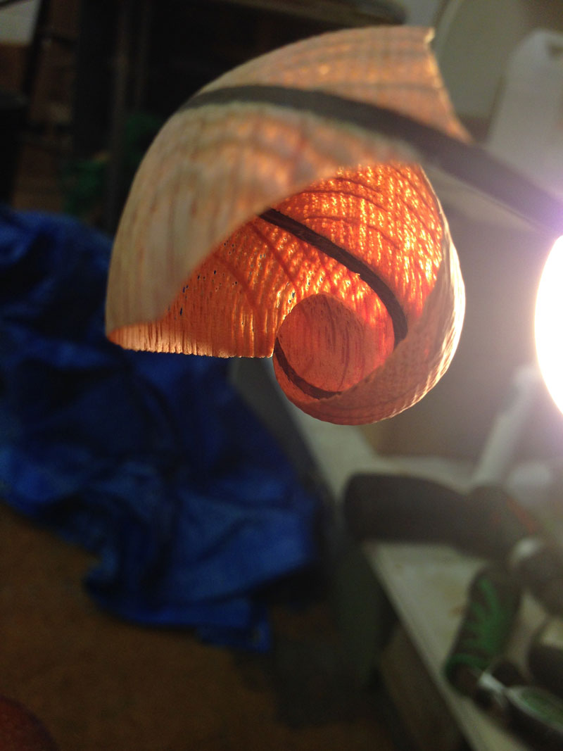

tarpan66
Posté le 24-07-2019 à 16:25:57  profilanswer
Non, un site de vente de bois aux usa…
Autre raison de pleurer, mais à l'opposé total : Myriam Carpenter…
https://www.cleavermagazine.com/wp-content/uploads/2016/02/Feather-11888.jpghttps://www.cleavermagazine.com/wp-content/uploads/2016/02/Feather-11889-11888-11887.jpg
https://www.cleavermagazine.com/wp-content/uploads/2016/02/2015-04-13-22.27.34.jpg
https://www.cleavermagazine.com/a-p [...] carpenter/
