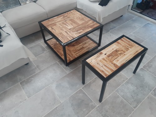

Carbon'R
Fahren macht frei
Posté le 09-06-2021 à 21:34:25  profilanswer
#boismoche
https://img.super-h.fr/images/95c2dbe578e40b90afa39821aa136583.md.jpg
A new power is rising
