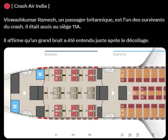

yardbirds a écrit :
Siège 11a apparemment
Oui
https://www.unilad.com/news/world-n [...] 5-20250612
It all happened so quickly," he said. "When I got up, there were bodies all around me. I was scared. I stood up and ran. There were pieces of the plane all around me. Someone grabbed hold of me and put me in an ambulance and brought me to the hospital.
Ramesh was sat in 11A on the aircraft, while his brother - also on board - was seated in an entirely different row, Ramesh told the Hindustan Times.
Message édité par Profil supprimé le 12-06-2025 à 20:34:42

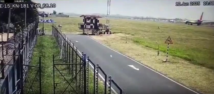

Encore une fois RAT sortie = perte de puissance sur les 2 générateurs principaux (moteurs). La RAT est bien visible sur un angle de la première vidéo.
https://img3.super-h.fr/images/2025 [...] 817bda.jpg
 [:leraturbain:6]
La qualité Boeing...
n°73045200
