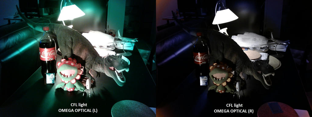

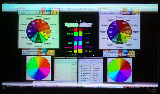

n°8320862
BlackShark
En 3D c'est mieux.
Posté le 21-05-2012 à 02:10:37  profilanswer
Hello
quelques images intéressantes pour l'instant sans commentaires.
Le texte : demain
http://www.mediafire.com/conv/b9aaea39be8bccec0e4ea444e37f893cc32099afd9423ebccba64f2a26775e214g.jpghttp://www.mediafire.com/conv/b454d2a8e6d4cc7b417e6196b0f38efa7c8dc49bb9af00ff0372fe42845533b74g.jpghttp://www.mediafire.com/conv/d9c938f0fcde068fafe352d0d4bc6d292a5a8aeda561a93d5426e5fa0fa51e494g.jpg
https://sites.google.com/site/passive3d/_/rsrc/1334260386342/Downhome/Topic1/part1knowledgerepresentationinprolog20/v7%20E.bmp?height=295&width=513
https://sites.google.com/site/passi [...] inprolog20
http://www.mediafire.com/conv/c9e94bfd601eac199d80369438e94ab9e53ca51681e03d893e3d21821fb4a73e4g.jpghttp://www.mediafire.com/conv/7ebd434ab2e3b6f4275a9195167b97379dcc7f45bfe6179ce3ae065d8012a3714g.jpg
http://www.mediafire.com/conv/096fec3372addd11e56db83a45e3e8217926693fe26e75247d55653fc2b2b8196g.jpg
http://www.mediafire.com/conv/4fbded64570a8a3dbc9c32eee596ee517c2a075f26d630d981270a1fae8c77714g.jpghttp://www.mediafire.com/conv/6107a420fad7b96a7284e91faccb6848175c993edc5881bab49674faf59bbd2d4g.jpg
http://www.mediafire.com/conv/b3681cb2dedeb84e99c9165f8b82932d562a963c98fc85f5fade22a5196ac8324g.jpghttp://www.mediafire.com/conv/47e4d46420d1eb55f8c70a0475b6aeb363fe13a8d9063157ad614e6514534c8d4g.jpghttp://www.mediafire.com/conv/db5c21887d9478f2a50791b2d60e28dd5a699a04b1e6d8dfa20755ca2ec9e2bf4g.jpg
http://www.mediafire.com/conv/3fe63d18cc241e560732e561510e413a7c4c51adeb1a297a32995c0d2a1db8754g.jpghttp://www.mediafire.com/conv/60468da6258a8fcf8432c5640a0eadc03ca2a20b79bc79e34336b82ffb45986f4g.jpg
http://www.mediafire.com/conv/6f7fa554380a47cb92b61f2edb99fadd312e045ebddaf6aad5ac630c6a2bc9a14g.jpghttp://www.mediafire.com/conv/ecf7d975511c01da64b9db770e9ce98bc1b4d22dba468b84236d975e495212064g.jpg
http://www.mediafire.com/conv/7cca3812478eafda5e9a0a4c984cae6782f8717185edf6fcaa669dd55f94a8bc4g.jpghttp://www.mediafire.com/conv/6a8154c58671c8caf8e282ea7e7ad7300d93a4a346280b8c113fe1f6d945462f4g.jpg
http://www.mediafire.com/conv/fddd6b081254cb11ffd1aa7024f64419d7fce37c874565f673665b26d927f6bb4g.jpghttp://www.mediafire.com/conv/adf2786a36aa209eac804c67f3970927be0c34d91d10617c9e185e13ef1b208b4g.jpg
http://www.mediafire.com/conv/9ab393e65b4c94e480984b96a73c114cd8e76114d3b008ba76626b5c31d0e2674g.jpghttp://www.mediafire.com/conv/db2d90805f785960c77256051c73382844b50a517289b881157014616e5290754g.jpg
Message édité par BlackShark le 22-05-2012 à 00:46:32

Posté le 22-05-2012 à 14:52:50  profilanswer
sympa ces photos
c'est impressionnant l'efficacité des filtres a selectionner une bande etroite et a parfaitement bloquer le reste. rien que ca suffis a dire qu'il faut continuer a creuser cette voix malgres les contraintes sur la colorimetrie
j'aimerais bien voir ce genre d'aproche mais sur de la projection laser (direct ou indirect) avec des lasers qui fonctionnerait si possible sur des bandes tres etroite et proche (2 lasers different mais tres proche pour le rouge, le vert et le bleu) et donc des filtres uniquement sur les lunettes (a 3 bandes tres etroite)
si un jour ce genre de chose est possible et que le videoprojecteur integre directement la double projection et la gestion de la 3D alors je pourais vraiment me laisser tenter par la videoprojection malgres que ce soit pas quelque chose qui me tente a priori mais une 3D sans ghosting, sans motion tearing et lumineuse ca se refuse pas
tu dois bien t'amuser avec les filtres, ca doit donner des truc un peu bisarre quand tu regarde certain truc avec (certaine sources de lumieres ou certain type de led par exemple?)

Donc là blackshark, si tu utilise ton projo avec un éclairage artificiel (ampoules fluocompactes) dans ton apart, tu vois l'image projetée avec des couleurs à peut près normales mais la pièce dans laquelle tu es, tu vois très sombre via un œil et verdâtre sombre via l’autre? N'es-ce pas gênant?

BlackShark a écrit :
Le texte : demain
 :whistle:
n°8328879
BlackShark
En 3D c'est mieux.
Posté le 27-05-2012 à 19:28:18  profilanswer
Ahem... oui ben euh .... oui demain quoi...  :ange:
Oui, tout éclairage artificiel est gênant.
Cela concerne les lampes CFL et ma petite lampe de bureau à LED. Je n'ai pas essayé l'incandescence, je n'en ai pas à proximité. La lumière du jour par contre est neutre.
Mais quoi qu'il en soit, je dispose de trop peu de Lumen pour me permettre d'avoir de l'éclairage d'ambiance, de plus la lumière ambiante passe à l'intérieur des lunettes et créent des reflets parasites importants (les filtres sont des filtres à interférence : ce qui ne passe pas est réfléchit) donc lorsque j'utilise le projo, j'éteins tout.
