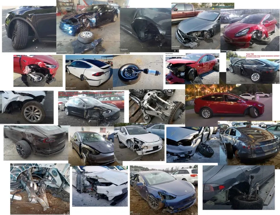

https://rehost.diberie.com/Picture/Get/f/398975
