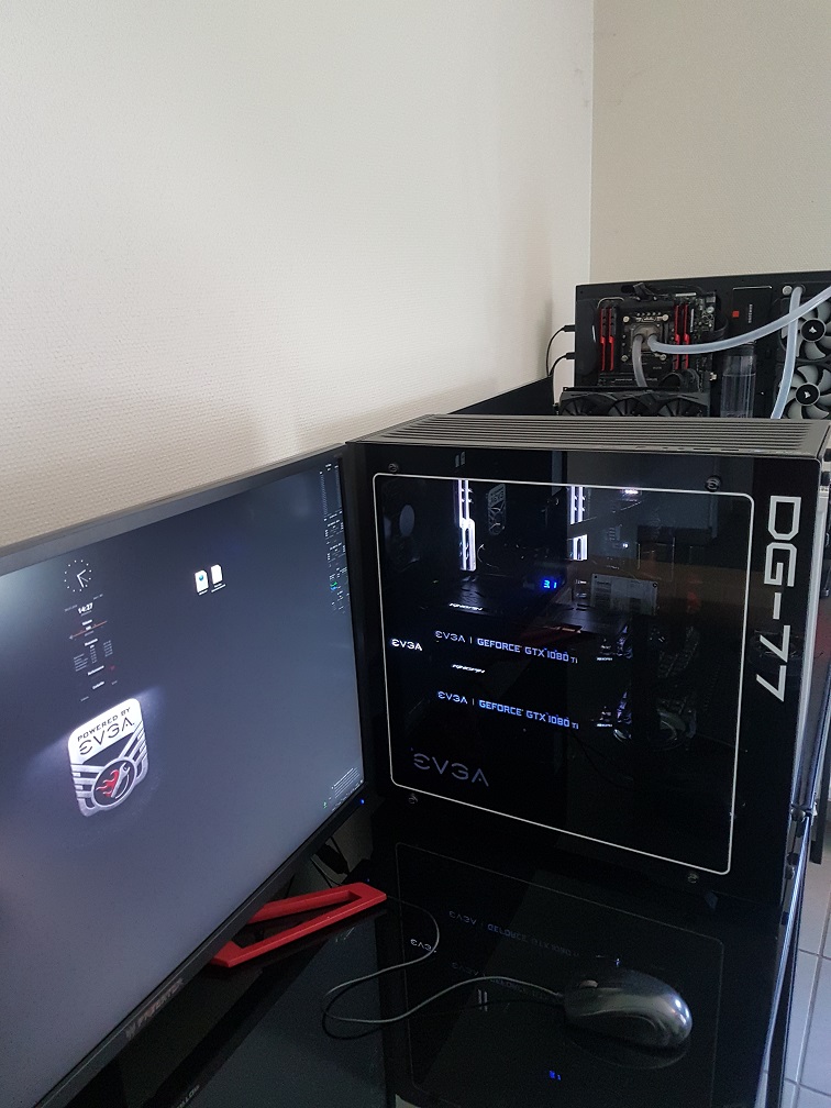

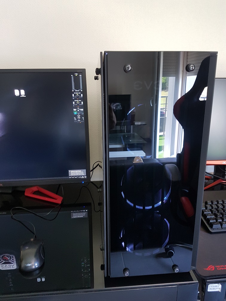

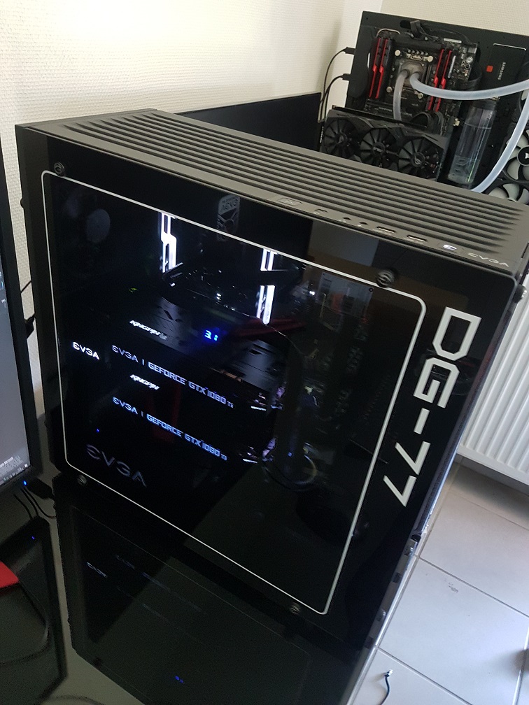

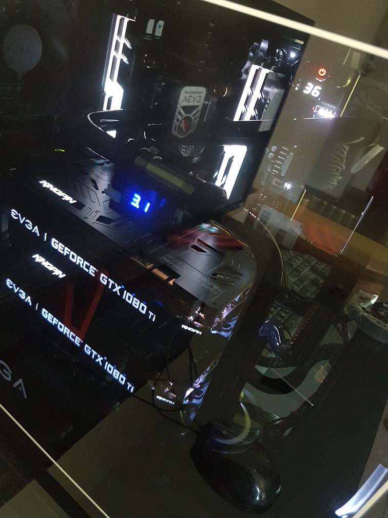

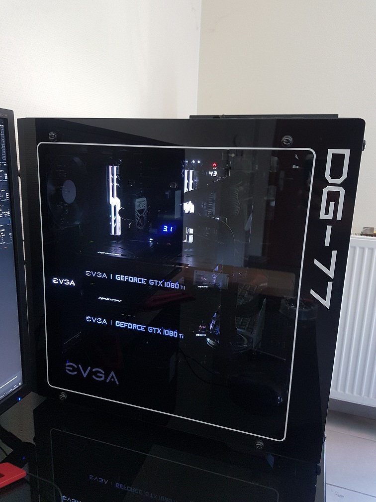

bonsoir à vous.......résultat final du mods EVGA..
https://reho.st/self/60c13d7a4293a148b6bc5919a227b885f926a32d.jpg
https://reho.st/self/af0c417d503b98128562ef79b249220136ca856a.jpg
https://reho.st/self/8c09ca65e53fdbac52b4ebb60a61a4f10b053b63.jpg
https://reho.st/self/33e585e3198324abdfab3851b99f21486fffbce5.jpg
https://reho.st/self/68ffa50ba142ed678462cf2d741165609738782a.jpg
