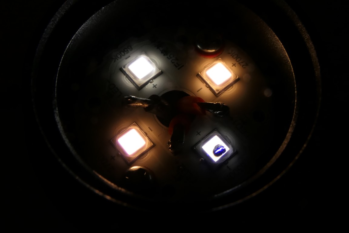

Charles K
Posté le 22-08-2020 à 19:48:11  profilanswer
https://i.postimg.cc/P5Tnn87K/P1020338-Moyen.jpg
 [:art_dupond]
