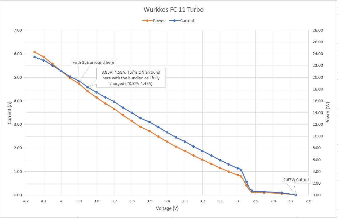

Ce test semble indiquer qu’il y a une protection dans la lampe, mais pas dans l’accu.
One significant runtime difference between S1R Baton (Turbo S) and S1R Baton II is S1R Baton (Turbo S) will switch off on ORB-163C05 Low Voltage (battery Over-discharge) Protection kicks-in, while the new S1R Baton II will turn itself off when ORB-16C05-10C is at ~2.4V (underload). In other words, this new S1R Baton II has battery Over-discharge Protection built-in.
When S1R Baton II battery Over-discharge protection kicks-in, the protection can be reset by connecting S1R Baton II to the MCC II. At ~3.5V, it will be reset as you can start the light back on.
The S1R Baton II battery Over-discharge Protection can be bypass (highly not recommended, unless you absolutely urgently need some lights) by loosening the body and tightening it back on, you should be able to get Low and possibly Medium Mode. However, note that the in-light Over-discharge Protection may not be activated as can be acknowledged via the non-functioning of the battery level indicator at the electronic side-switch.
If you go the bypass route, do take note that your battery, in this case, ORB-16C05-10C will be discharge as low as possible. I stop my discharge test when it reaches 1.8V underload to not risk further damaging the battery.

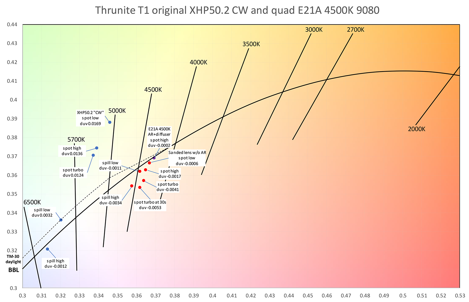

J’ai remplacé l’XHP50.2 bien dégueux dans ma Thrunite T1 par une quad E21A en 4500K CRI>90.

Comparaison du faisceau avec la led d’origine très verte (et bleu dans le spill):
https://thumbs2.imgbox.com/a3/55/Mo0eb1Qt_t.jpg
Mesures colorimetriques [:klem3i1] :
https://i.postimg.cc/4Jv2tS9T/cie-plot-1000p.png
Teinte on ne plus parfaite

Album avec un peu plus de photos notamment du bricolage : https://imgur.com/a/yLvixLx (voir en version ordinateur sur mobile sinon c’est la bouillie de pixels)

Ceux qui ont la FC11, vous savez quel type d'accu exactement est inclus dedans ?
http://budgetlightforum.com/node/70833
Il n'y a aucune info. Est ce qu'elle peut supporter un drain de 6A pensez vous ?
n°60318617
Charles K
Posté le 24-07-2020 à 14:53:05  profilanswer
Pas de détails, juste "3000 mAh" et "made in China", je l'avais mesuré à 2950mAh si je me rappelle bien avec une décharge à 500mA jusqu'à 2.8V, jusqu'à 2.5V à 200mA il aurait probablement fait les 3000 spécifié.
Résistance interne de 40~45mΩ, donc 6A serait probablement la limite haute pour une décharge continue.
J'avais mesuré le courant en fonction de la tension et la FC11 ne tire que ~4.5A max et pas pour très longtemps, donc pas de problème.
https://i.postimg.cc/PqwCWdzn/Wurkkos-FC11-current-power.png
