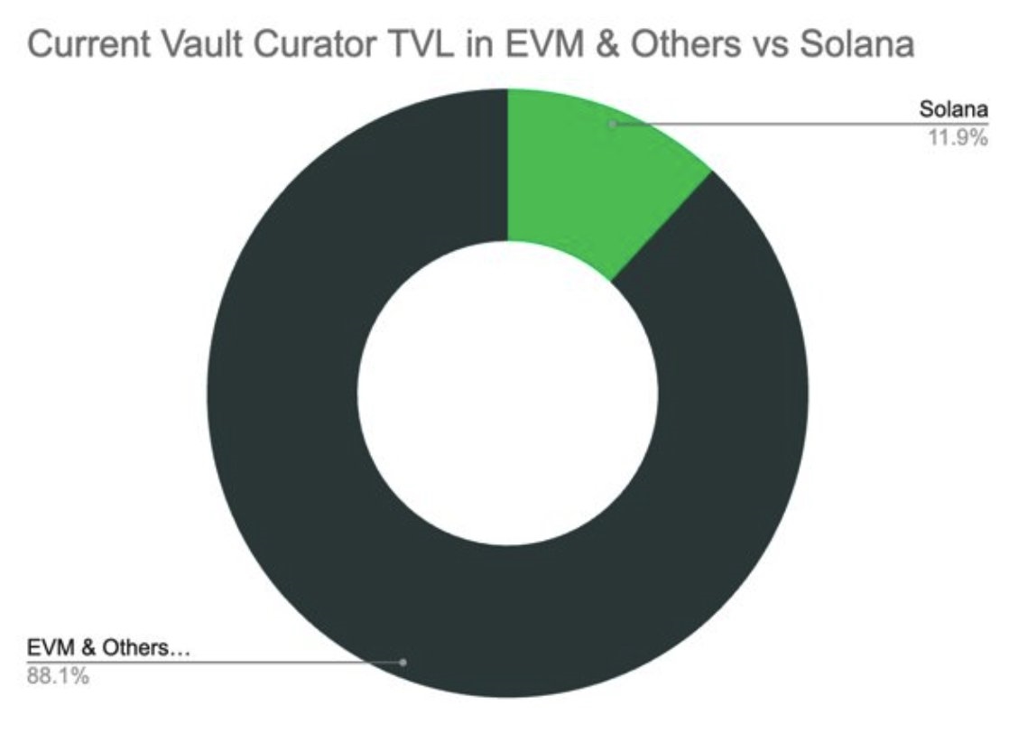

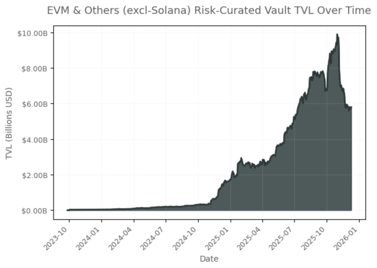

X sloane [:yoann riou:9] (@0xsloane)
Institutions are entering crypto on-chain through vault-curation.
7-12% yields are attractive enough beyond the 4-6% staking hurdle rate and risk-curated by sophisticated managers to not be too risky.
Vault-curated TVL on EVM (& others excl Solana) exploded 20x since late-2023 -> peaking at $10B (see the shaded grey chart).
On @solana, we're only getting started; it currently only has ~12% of TVL in risk-curated vaults.
