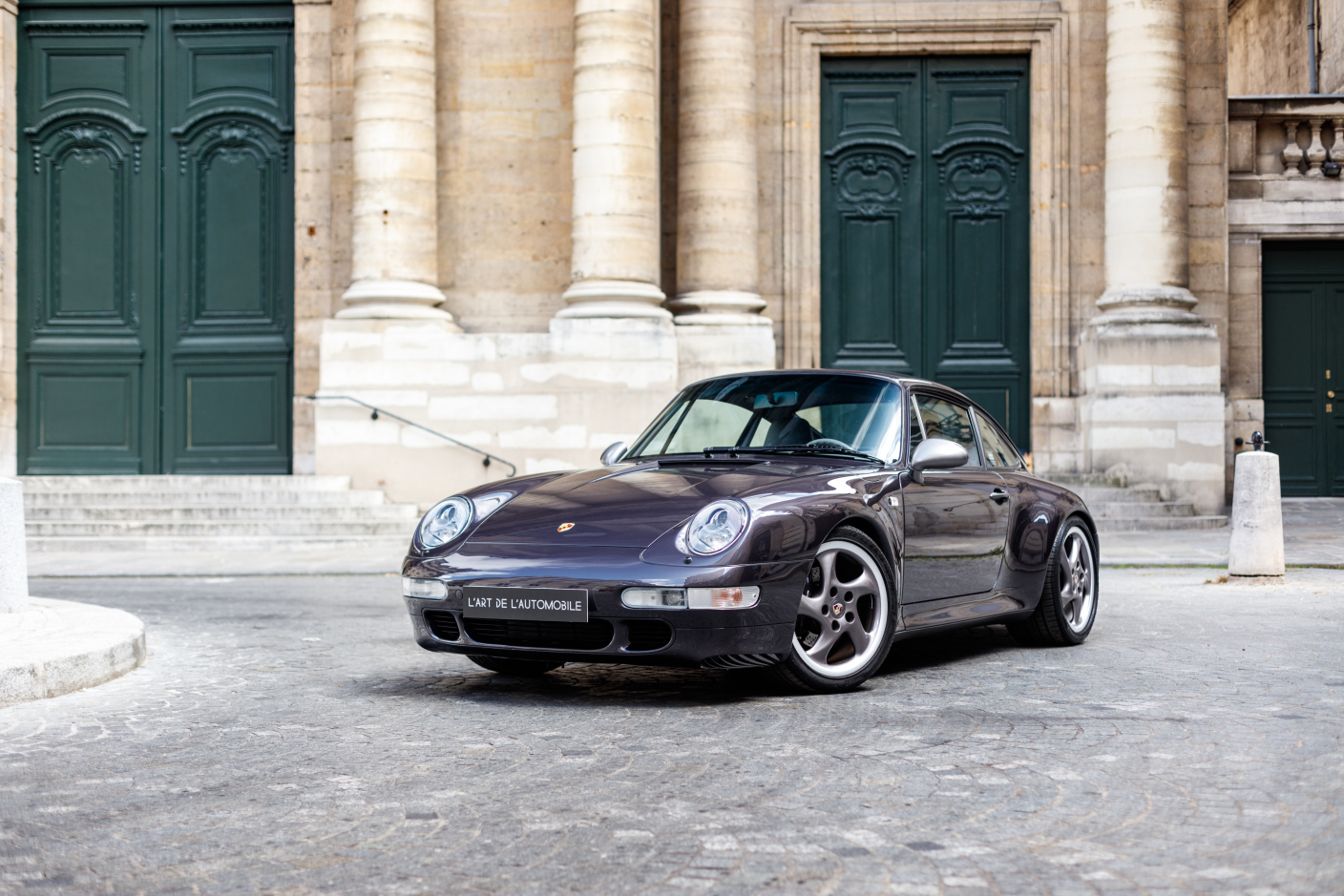

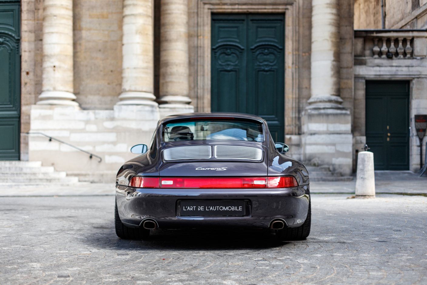

Petite disgression :o :
https://scontent-mrs2-1.xx.fbcdn.net/v/t1.0-9/71831635_10157830290917235_1903760948489879552_n.jpg?_nc_cat=103&_nc_oc=AQlTnXZNhbl9QcKuOTU5OLH_kW_A2kEFbXN5tfoMruT-XO9qqYloWjlYFNWHNrRLPB6HHARZGSZkE4NPcAssW0BO&_nc_ht=scontent-mrs2-1.xx&oh=e63104d46b9384a99684bdbfbf630b1b&oe=5E61E7B6

Bon week-end à tous!
http://res.cloudinary.com/dsxfn6o4q/image/upload/v1531821670/eksgvk5abtmr5jihjirw.jpg
http://res.cloudinary.com/dsxfn6o4q/image/upload/v1531821695/vyx1o4dhrbot7kwv7nhp.jpg

Posté le 31-10-2019 à 14:10:18  profilanswer
Plus belle arrière, plus moche avant des 911  :(

Totalement d'accord :)
