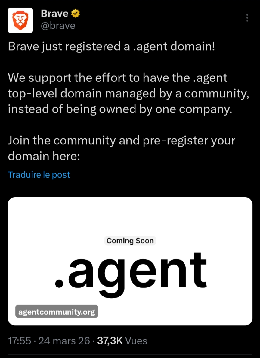

https://rehost.diberie.com/Picture/Get/f/500542
https://x.com/i/status/2036487180256686084
 :O
