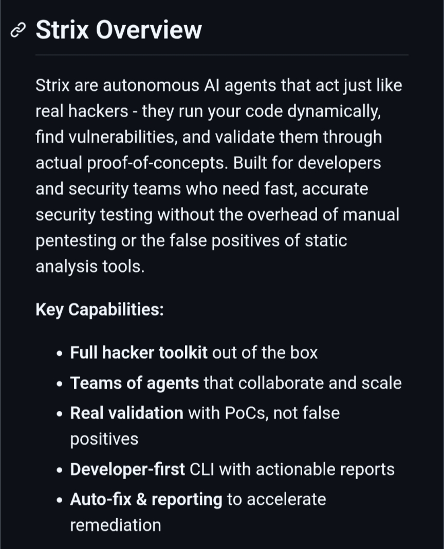

Posté le 23-04-2026 à 10:16:49  profilanswer
https://rehost.diberie.com/Picture/Get/r/508556
https://github.com/usestrix/strix
