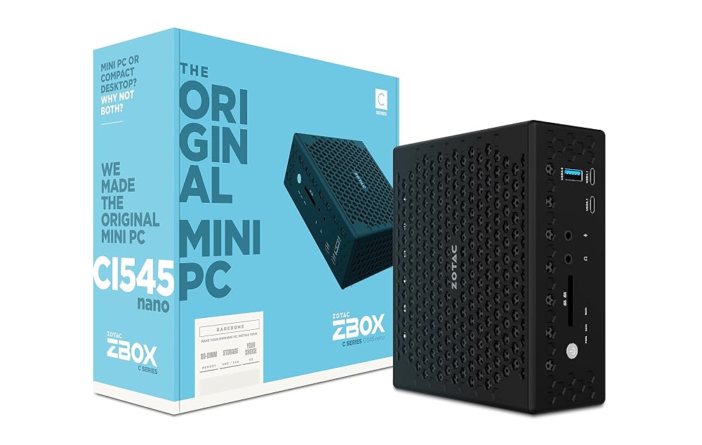

ZBOX Skylake, les clients US n'aiment pas non plus!
"Very disappointed. I buy this NUC for its fanless design. But unfortunately, the CPU temperature is too high to be stable. Another issue is the Bluetooth, my brand new Microsoft Designer Bluetooth Desktop set could not work with this NUC, no idea if due to the overheat. I returned this product and have a Intel NUC with 6th gen i5, then everything is fine."
https://www.amazon.com/gp/review/R1 [...] imp_1rv_cl
https://images-na.ssl-images-amazon.com/images/I/81rW6I-V3tL._SL1000_.jpg
https://www.fanlesstech.com/
