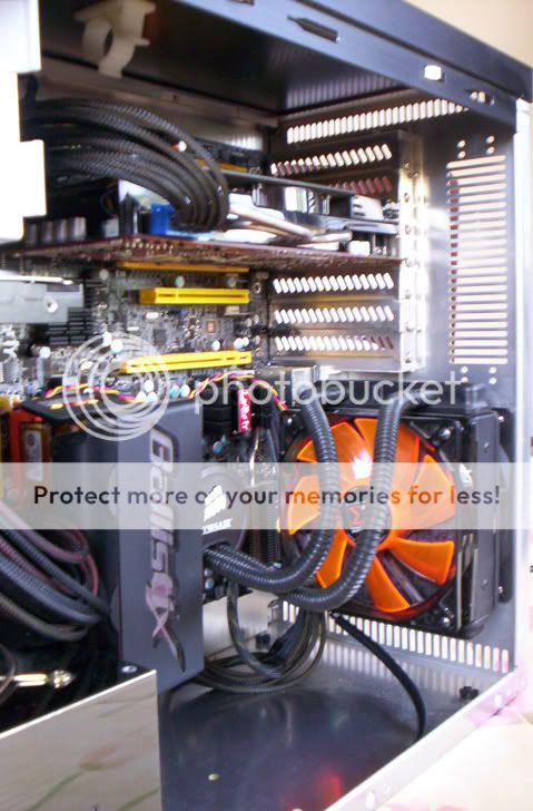

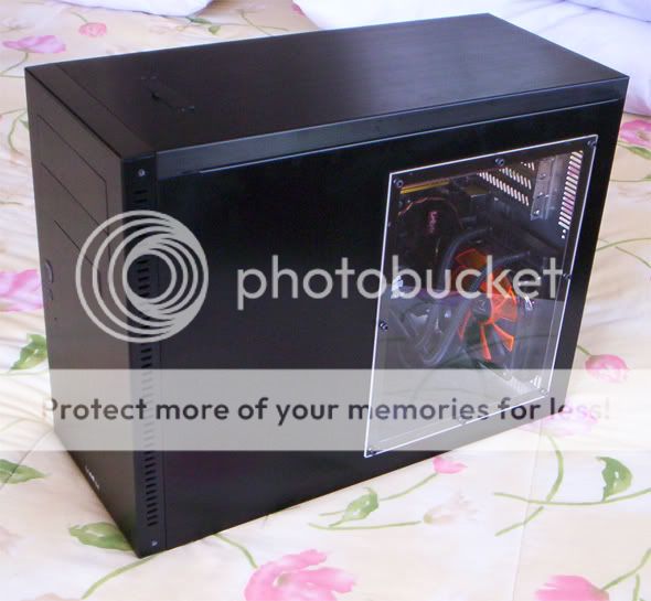

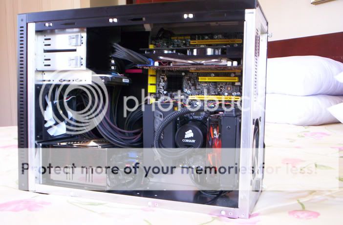

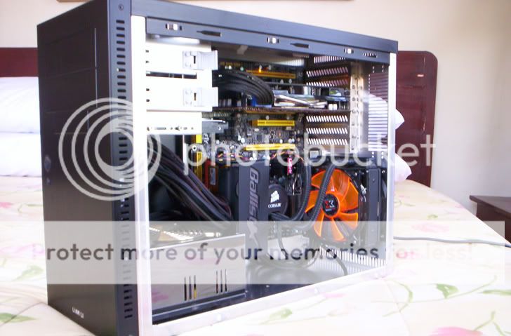

http://i661.photobucket.com/albums/uu335/gerard_albert_canada/icebox_4-1.jpg
http://i661.photobucket.com/albums/uu335/gerard_albert_canada/icebox_5.jpg
http://i661.photobucket.com/albums/uu335/gerard_albert_canada/icebox_3.jpg
http://i661.photobucket.com/albums/uu335/gerard_albert_canada/icebox_2.jpg
Posté le 11-08-2010 à 10:19:42  profilanswer
n°7528778
Sergent_Ga​rcia
Zorro la tapette !
Posté le 11-08-2010 à 11:03:14  profilanswer
Il est joli le gainage...C'est quoi l'alim ? :)
n°7529748
DcW_Freeze
Posté le 11-08-2010 à 19:34:56  profilanswer
Zumax 750W (e-power)
Sorry guys i can only speak English.. :D
(using google translator)
