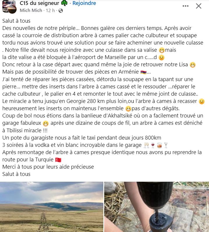

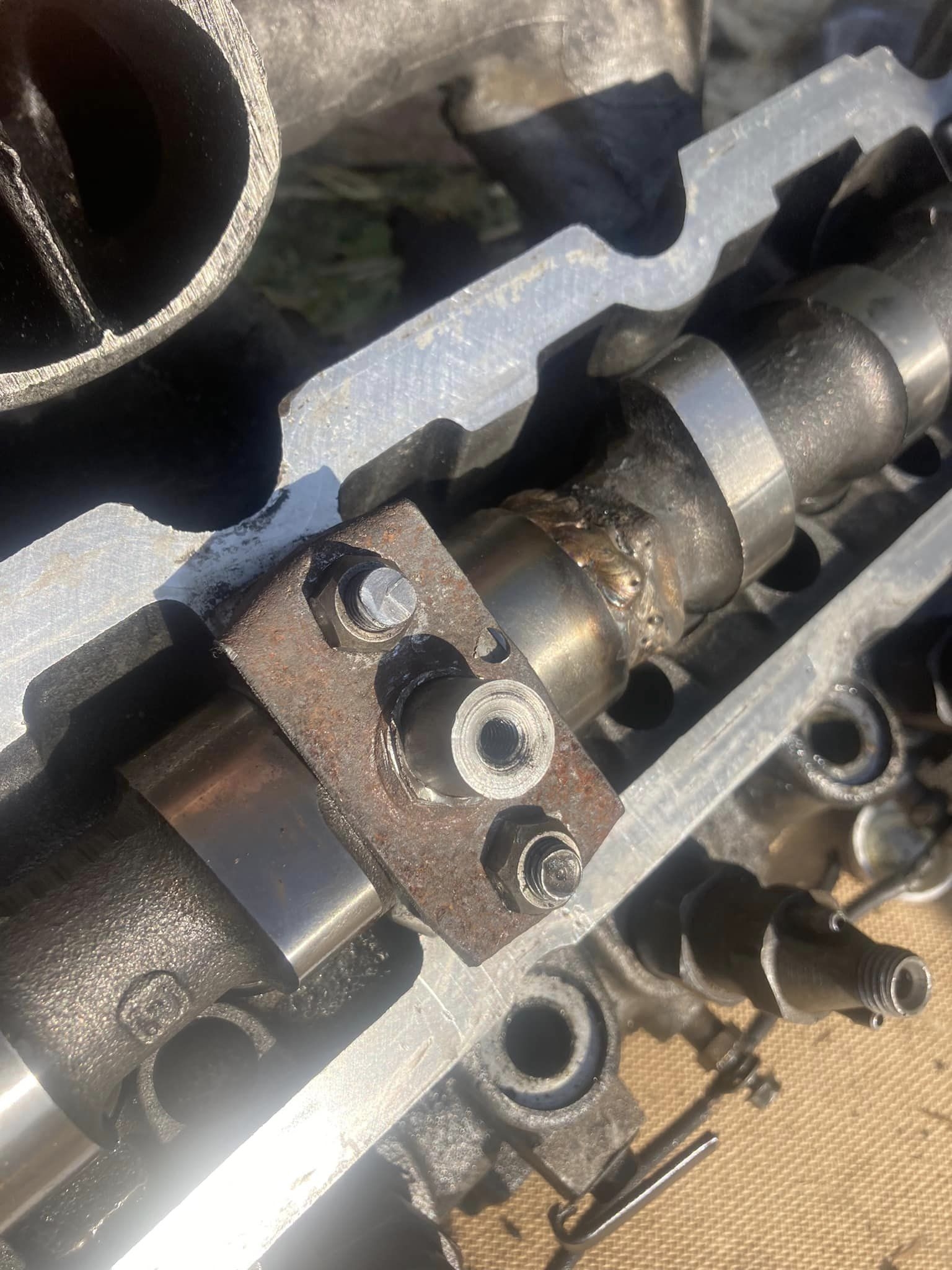

Amis de la fine mécanique, bonjour :o
https://www.facebook.com/groups/394 [...] ently_seen
https://rehost.diberie.com/Picture/Get/f/314954
https://rehost.diberie.com/Picture/Get/f/314955
https://rehost.diberie.com/Picture/Get/f/314956

[:50dlanj:4]
Quand même
