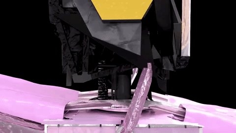

Webb’s Deployable Tower Assembly Extends in Space
This afternoon, the Webb team successfully extended the observatory’s Deployable Tower Assembly (DTA), creating critical distance between the two halves of the spacecraft.
The DTA extended about 48 inches (1.22 meters), putting room between the upper section of the observatory, which houses the mirrors and scientific instruments, and the spacecraft bus, which holds the electronics and propulsion systems. This creates enough distance to allow the sensitive mirrors and instruments to cool down to the necessary temperatures to detect infrared light. This gap will also provide room for the sunshield membranes to fully unfold.
The deployment took more than six and a half hours, as engineers activated release devices and configured heaters, software, and electronics, before commanding the DTA itself to extend. The movement of the DTA, which looks like a large, black pipe, is driven by a motor. The team began the deployment at approximately 9:45 a.m. EST and completed it at approximately 4:24 p.m. EST.
This step furthers the team’s progress in deploying Webb’s sunshield – a human-controlled, multi-day process that will continue with the release of aft momentum flap and the sunshield covers.
https://blogs.nasa.gov/webb/2021/12 [...] -in-space/

H+5 jours : Déclenchement du volet d'inertie arrière et des couverture de la membrane de protection solaire.
https://jwst.nasa.gov/content/webbLaunch/assets/images/deployment/thumbnails/110.png https://jwst.nasa.gov/content/webbLaunch/assets/images/deployment/thumbnails/111.png
Aujourd'hui est censé être le d'ploiement du volet d'inertie arrière qui est utilisé pour aider à compenser une partie de la pression solaire qui s'exerce sur le grand pare-soleil. L'utilisation du volet d'inertie permet de minimiser la consommation de carburant pendant la mission. Après avoir libéré les dispositifs de retenue, un ressort entraîne la rotation du volet arrière jusqu'à sa position finale.
Une 2e opération aujourd'hui devrait permettre de libérer et d'enrouler la couverture de la membrane de protection. Le couvercle de libération du pare-soleil a protégé les membranes pendant les activités au sol et le lancement. Les dispositifs de libération sont activés électriquement pour libérer les couvertures.

SCEtoAUX
413 is in.
Posté le 01-01-2022 à 05:20:35  profilanswer
Confirmation que le pare-soleil a été correctement déployé. Prochaine étape: la mise en tension des cinq couches du pare-soleil.
With Webb’s Mid-Booms Extended, Sunshield Takes Shape
With the successful extension of Webb’s second sunshield mid-boom, the observatory has passed another critical deployment milestone. Webb’s sunshield now resembles its full, kite-shaped form in space.
Engineers began to deploy the second (starboard) mid-boom at 6:31 p.m. EST and completed the process at about 10:13 p.m. EST.
The completion of the sunshield cover and mid-boom deployments over the past two days marks a critical milestone for Webb: all 107 membrane release devices associated with the sunshield deployment — every single one of which had to work in order for the sunshield to deploy — have now successfully released. Webb has 178 of these ‘non-explosive actuators’ in all; 107 were used to keep the sunshield safe and folded prior to deployment.
As the mid-booms slowly pushed out horizontally from the spacecraft, each driven by a motor, they pulled the folded membranes of the sunshield with them. This extended the sunshield to its full 47-foot width all the way across the observatory.
“The mid-booms are the sunshield’s workhorse and do the heavy lifting to unfold and pull the membranes into that now-iconic shape,” said Keith Parrish, Webb observatory manager at NASA’s Goddard Space Flight Center.
While the deployments took longer than expected today, that was due to the operations team moving forward with caution and according to the protocols they laid out for dealing with unpredictable situations.
“Today is an example of why we continue to say that we don’t think our deployment schedule might change, but that we expect it to change,” Parrish said. “The team did what we had rehearsed for this kind of situation – stop, assess, and move forward methodically with a plan. We still have a long way to go with this whole deployment process.”
The two mid-boom arms are now locked in their final position. They will hold the sunshield membranes in their proper place, as the team turns to the final stage in the sunshield’s deployment: tensioning.
In the coming days, the team will separate and then individually tension each of the five sunshield layers, stretching them into their final, taut shape. This will create space between the membranes to allow heat to radiate out, making each successive layer of the sunshield cooler than the one below.
Webb’s engineers will begin with the bottom layer – the largest and flattest layer, which is closest to the Sun and will reach the highest temperatures. They will proceed sequentially to the fifth and smallest layer, closest to the primary mirror. Tensioning the layers involves sending commands to activate several motors to reel in a total of 90 cables through numerous pulleys and cable management devices. Sunshield tensioning will take at least two days but may take longer, due to the complexity of the process and the flexibility built into the timeline.
