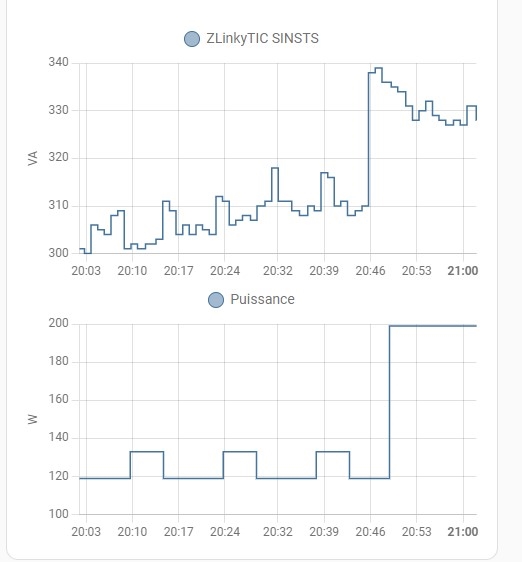

Phenix21 a écrit :
@shaad : merci beaucoup  :jap: , ça fonctionne nickel !
https://rehost.diberie.com/Picture/Get/t/164518
La mise en route du frigo me fait bien remonter le cos phi de l'installation  :p
Au passage, des spécialistes de ZLinky_TIC et de Z2M ? Je souhaiterais ne pas faire remonter le current_date (aucune utilité, 1 remontée par minute), et par contre augmenter la fréquence de east, mais je ne sais pas comment paramétrer tout ça
Merci !
https://rehost.diberie.com/Picture/Get/t/164520
Tu peux partager ton flux stp pour le calcul W stp ?
Pour ta seconde question, j'ai pas tenté mais je suppose que si tu précises en whitelist les quelques params qu'ils te faut, par défaut ca filtre les autres..
Pour un index en kWh en entrée :
Code :
  1. [{"id":"fd0461cb141e1313","type":"change","z":"1cab2f05.23c531","name":"TimeStamp","rules":[{"t":"set","p":"payload","pt":"msg","to":"","tot":"date"}],"action":"","property":"","from":"","to":"","reg":false,"x":310,"y":1060,"wires":[["6529ac9347a6e518"]]},{"id":"fde0c27846e685fc","type":"api-call-service","z":"1cab2f05.23c531","name":"Update Puissance","server":"61ee2d7b.f0bad4","version":5,"debugenabled":false,"domain":"input_number","service":"set_value","areaId":[],"deviceId":[],"entityId":["input_number.puissance"],"data":"{\"value\" : msg.payload}","dataType":"jsonata","mergeContext":"","mustacheAltTags":false,"outputProperties":[],"x":790,"y":1060,"wires":[[]]},{"id":"d1d84fcff49dd21a","type":"server-state-changed","z":"1cab2f05.23c531","name":"Teleinfo Index","server":"61ee2d7b.f0bad4","version":4,"exposeToHomeAssistant":false,"haConfig":[{"property":"name","value":""},{"property":"icon","value":""}],"entityidfilter":"sensor.zlinkytic_east","entityidfiltertype":"exact","outputinitially":true,"state_type":"num","haltifstate":"","halt_if_type":"num","halt_if_compare":"is","outputs":1,"output_only_on_state_change":false,"for":"","forType":"num","forUnits":"minutes","ignorePrevStateNull":false,"ignorePrevStateUnknown":false,"ignorePrevStateUnavailable":false,"ignoreCurrentStateUnknown":false,"ignoreCurrentStateUnavailable":false,"outputProperties":[{"property":"payload","propertyType":"msg","value":"","valueType":"entityState"}],"x":110,"y":1060,"wires":[["7e57111b024e83cb","fd0461cb141e1313"]]},{"id":"7e57111b024e83cb","type":"change","z":"1cab2f05.23c531","name":"Index Teleinfo","rules":[{"t":"set","p":"Index","pt":"flow","to":"payload","tot":"msg"}],"action":"","property":"","from":"","to":"","reg":false,"x":340,"y":1009,"wires":[[]]},{"id":"6529ac9347a6e518","type":"function","z":"1cab2f05.23c531","name":"Calcul de Puissance","func":"var Timestamp = Number(msg.payload);\nvar Index = Number(flow.get(\"Index\",\"file\" ));\nvar Prev_Index = Number(flow.get(\"Prev_Index\",\"file\" ));\nvar Prev_Timestamp = flow.get(\"Prev_Timestamp\",\"file\" );\nvar Puissance;\n\n // Get a pretty date in the format: `Mar 20, 13:04`\nvar date = new Date().toLocaleDateString('fr-FR', {\n    month: 'short',\n    day: 'numeric',\n    hour12: false,\n    hour: 'numeric',\n    minute: 'numeric'\n})\nvar statusText;\n\nif (isNaN(Index))\n{\n    flow.set(\"Index\", 0, \"file\" );\n}\n\nif (isNaN(Prev_Index))\n{\n    flow.set(\"Prev_Index\", Index, \"file\" );\n    flow.set(\"Prev_Timestamp\", Timestamp, \"file\" );\n}\nelse if ((Timestamp - Prev_Timestamp > 30000) && (Index > Prev_Index + 0.001))\n{\n    Puissance = Math.round((Index-Prev_Index)/(Timestamp-Prev_Timestamp)*1000*3600000);\n\n    flow.set(\"Prev_Index\", Index, \"file\" );\n    flow.set(\"Prev_Timestamp\", Timestamp, \"file\" );\n\n    statusText = Puissance + ` at: ${date}`\n    node.status({fill: \"green\", shape: \"dot\", text: statusText});\n    msg.topic = \"Puissance\";\n    msg.payload = Puissance;\n    return msg;\n}","outputs":1,"noerr":0,"initialize":"","finalize":"","libs":[],"x":540,"y":1060,"wires":[["fde0c27846e685fc"]]},{"id":"feedf646c56e712d","type":"comment","z":"1cab2f05.23c531","name":"Puissance","info":"","x":140,"y":980,"wires":[]},{"id":"61ee2d7b.f0bad4","type":"server","name":"Home Assistant","version":5,"addon":true,"rejectUnauthorizedCerts":true,"ha_boolean":"y|yes|true|on|home|open","connectionDelay":true,"cacheJson":true,"heartbeat":false,"heartbeatInterval":"30","areaSelector":"friendlyName","deviceSelector":"friendlyName","entitySelector":"friendlyName","statusSeparator":"at: ","statusYear":"hidden","statusMonth":"short","statusDay":"numeric","statusHourCycle":"h23","statusTimeFormat":"h:m","enableGlobalContextStore":true}]
(c) @ Shaad  :)

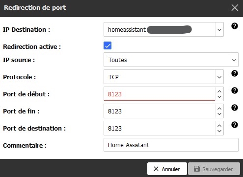

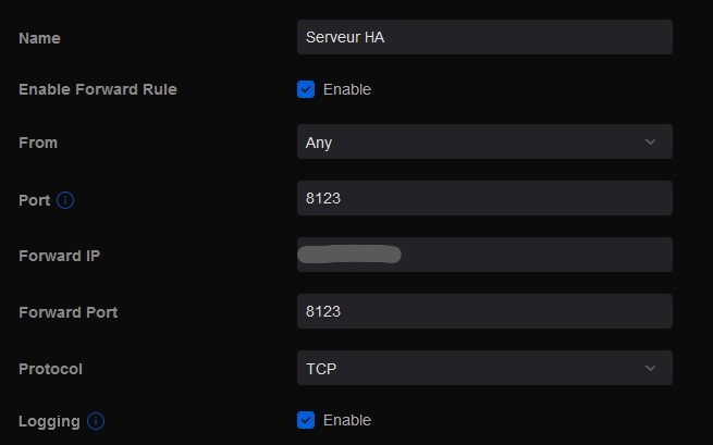

Bon, je pense avoir fait une grosse boulette [:shadow aok:2]
J'ai essayé de paramétrer un accès à distance via duckdns.
Je suis allé paramétrer un port forwarding sous Unifi, et c'est surement là que je me suis planté.
Bref, comme ça ne fonctionne pas, je ne peux plus accéder ni en local, ni via mon domaine duckdns :/
Je fais comment pour remettre la main sur HA ? :o
Edit : ok, fallait rajouter https devant mon URL locale :o
Désolé pour les questions de noob à longueur de journée :/
Message édité par Kelchacalcetype le 06-05-2023 à 22:15:35

J'essaie donc de créer un accès à distance sur HA, et j'ai du mal à comprendre certains trucs.
Voilà ma config :
Freebox
Switch Unifi USW 24 ports
HA sur un NUC branché sur le switch
J'ai commencé par créer un domaine via Duckdns, puis installé l'add-on Duckdns sous HA.
Dans l'add-on, j'ai bien entré en configuration le nom de domaine, ainsi que le token.
  • 1ère question, dois-je simplement ajouter ceci au fichier configuration.yaml ?
http:
  ssl_certificate: /ssl/fullchain.pem
  ssl_key: /ssl/privkey.pem
Ou bien dois-je indiquer le nom de domaine devant 'http:' ?
  • 2nde question : Dois-je appliquer une autre configuration sous HA, ou bien cette manip suffit ?
  • 3è question : j'ai du mal à comprendre si je dois faire un Port Forwarding sur ma freebox, ou bien sur l'UI Unifi, ou bien les deux ? :??:
Dans le cas de la Freebox, je suis bloqué :
https://rehost.diberie.com/Picture/Get/f/164864
Quand je passe la souris sur la ligne rouge, il m'est indiqué :
Vous devez choisir un port supérieur à 32768.
Quant au switch, j'ai créé un Port Forwarding avec la config suivante :
https://rehost.diberie.com/Picture/Get/f/164863
L'IP est celle de HA. Ceci vous semble correct ?
Je suis un peu perdu par rapport à ma config matérielle.
De plus, certains tutos parlent de demander une IP fixe, or depuis l'UI Unifi, la fonctionnalité n'est pas disponible, il faut rajouter du hardware en plus.
Bref, un peu d'aide ne serait pas superflu [:halp]

Je n'ai pas toutes les réponses, mais déjà :
- tu es chez Free avec une IP partagée, d'où le bug quand tu créé la redirection. Tu peux soit demander une IP full stack sur ton interface, soit accéder à ton instance HA depuis un port différent de l'extérieur (genre un port 48123, qui est bien dirigé vers le port 8123 interne)
- dans l'interface de la Freebox, tu peux assigner un IP fixe à un équipement via la page qui liste les matériels connectés au réseau
Code :
(c) @ Shaad  :)
Merci j'voulais comparer les resultats
https://rehost.diberie.com/Picture/Get/f/164922
PuissanceElec = calcul via node red
zlinky_conso_w = calcul via derivative
Tu peux obtenir la meme chose nativement sous HA avec les derivative
https://www.home-assistant.io/integrations/derivative/
Utilisable via integration ou via configuration.yaml
Code :
  1. - platform: derivative
  2.     source: sensor.zlinky_easf01
  3.     name: zlinky_conso
  4.     round: 3
  5.     unit_time: h
  6.     unit: kWh
  7.     time_window: 00:01:00
Code :
  1. - name: zlinky_conso_w
  2.       unit_of_measurement: "Wh"
  3.       icon: mdi:lightning-bolt-outline
  4.       state: "{{ (states('sensor.zlinky_conso') | float * 1000) | round(0)  }}"
Message édité par Dephi le 07-05-2023 à 12:53:05
