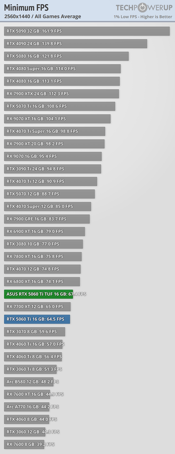

https://tpucdn.com/review/asus-geforce-rtx-5060-ti-tuf-16-gb/images/average-fps-2560-1440.png
https://tpucdn.com/review/asus-geforce-rtx-5060-ti-tuf-16-gb/images/minimum-fps-2560-1440.png
https://tpucdn.com/review/asus-geforce-rtx-5060-ti-tuf-16-gb/images/relative-performance-2560-1440.png
Ta 2080 = la RTX 4060 (non ti) 8Gb dans ces tableaux un peu près
