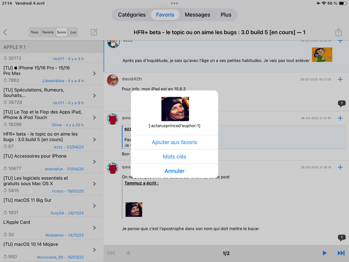

Posté le 04-04-2025 à 21:17:31  profilanswer
ChatGPT qui a réussi à me corriger le bug sur le single quote dans les smileys  [:skylvind:8]
https://img3.super-h.fr/images/2025/04/04/snapshot_1680717c86f8b1ea5ebb1.jpg

Il m'a proposé de remplacer les 2 lignes d'expression régulière par ce pavé et ça fonctionne du premier coup
NSString *html = myRawContent; // your original HTML input
NSError *error = nil;
NSRegularExpression *regex = [NSRegularExpression regularExpressionWithPattern:@"<img src=\"https://forum-images\\.hardware\\.fr/images/perso/([^\"]+)\" alt=\"\\[:([^\"]+)\\]\" title=\"[^\"]+\">" options:0 error:&error];
NSMutableString *mutableHTML = [html mutableCopy];
__block NSInteger offset = 0;
[regex enumerateMatchesInString:html options:0 range:NSMakeRange(0, html.length) usingBlock:^(NSTextCheckingResult * _Nullable match, NSMatchingFlags flags, BOOL * _Nonnull stop) {
    if (match.numberOfRanges == 3) {
        NSRange fullRange = [match rangeAtIndex:0];
        NSRange range1 = [match rangeAtIndex:1]; // $1: image file
        NSRange range2 = [match rangeAtIndex:2]; // $2: smiley code
        NSString *group1 = [html substringWithRange:range1];
        NSString *group2 = [html substringWithRange:range2];
        // Escape single quotes in group2
        NSString *escapedGroup2 = [group2 stringByReplacingOccurrencesOfString:@"'" withString:@"\\'"];
        // Construct replacement string
        NSString *replacement = [NSString stringWithFormat:@"<img onClick=\"window.location = 'oijlkajsdoihjlkjasdosmiley://smileycode/%@/'+encodeURIComponent(this.src); return false;\" class=\"smileycustom\" src=\"https://forum-images.hardware.fr/images/perso/%@\">", escapedGroup2, group1];
        // Adjust range to account for prior replacements
        NSRange adjustedRange = NSMakeRange(fullRange.location + offset, fullRange.length);
        [mutableHTML replaceCharactersInRange:adjustedRange withString:replacement];
        offset += replacement.length - fullRange.length;
myRawContent = mutableHTML;
