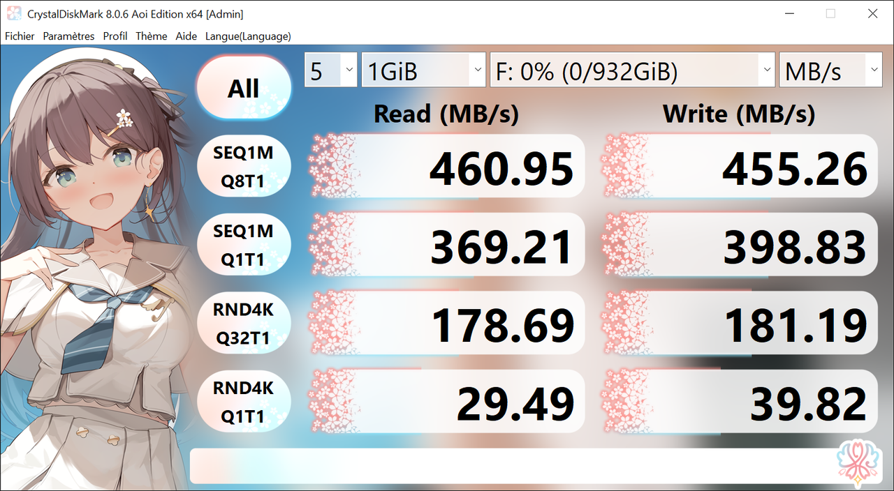

https://i.postimg.cc/D0CCbwNq/Crystal-Disk-Mark-20251208223404.png

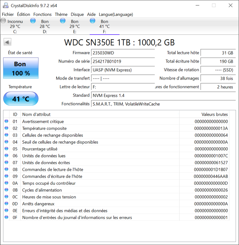

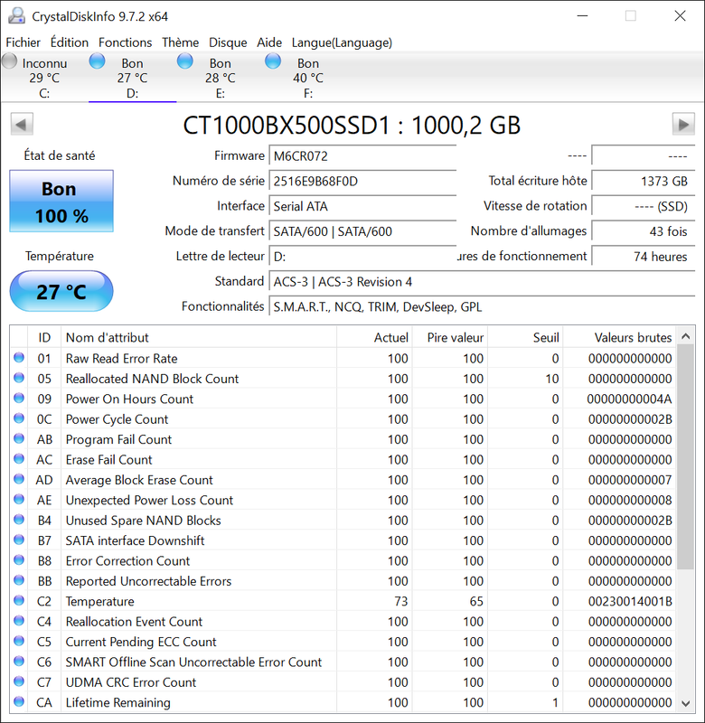

Disque dur interne SSD
https://i.postimg.cc/DyTsqhhM/disc-dur-interne.png
Disque dur externe SDD
https://i.postimg.cc/44zH40cv/disc-dur-externe.png
