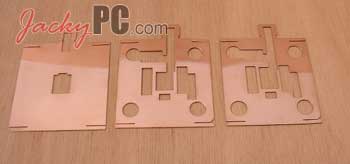

poweron http://www.jackypc.com/articles/91/6.jpg

plc [img] http://www.jackypc.com/articles/91/6.jpg [/img]
plc http://www.jackypc.com/articles/91/6.jpg
